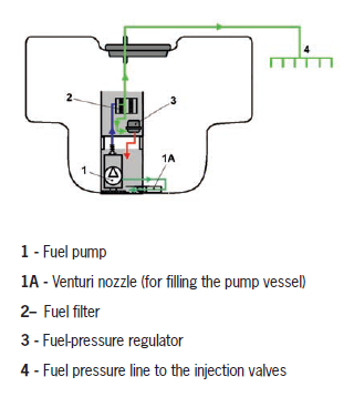

The fuel pressure regulator does not have a connection for the intake pipe pressure and is integrated into the fuel tank installation unit. Its nominal pressure is set at 55 psi ± 1.5 (3.8 ± 0.1 bar) for a flow rate of 21 gph (80 l/h). When running at idle speed, pressure is increased by approx. 1.5 psi (0.1 bar) due to the low fuel requirement of the engine. A holding pressure of > 29 psi (2 bar) should still apply one hour after switching off the engine.

i had change the fuel pump and regulator but problem still existed. how bout high pressure pump?

Seems strange that it would say the pressure is both low and implausible (does not understand the input signal). First step would be a fuel pressure test to find out where the pressure really is; if it meets specs, clear the codes and see if they come back. If the pressure really is low, further investigation will be required, possible pump replacement.
