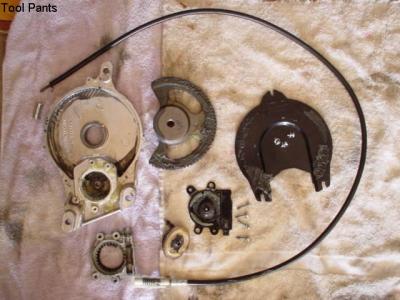

Mark and I have taken a few of the old style transmissions apart and they were in fine condition, and the top worked when the car was put back together.
Full retail on the new style transmissions and cables is about $1,000. That is what a dealer would do. We try to avoid that and get good parts back into working condition.

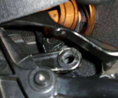

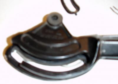

These bits live on the near side just behind the passenger where the roof pivots. I replaced all this (tricky job) but still not working. As you can see from the pics the guide rail had snapped and the bar was bent. Don't know how this happened, heard no noises last time I used it.
Anyway, I am suspecting that the motor switch thing isn't kicking in to tell the roof to stop. I put it all together and got the roof down but when I put it up again its looks like it is up but the light doesn't go out and then it pops of the gear again. It has to be some sensor not stopping the motor as mechanically it all looks fine.
