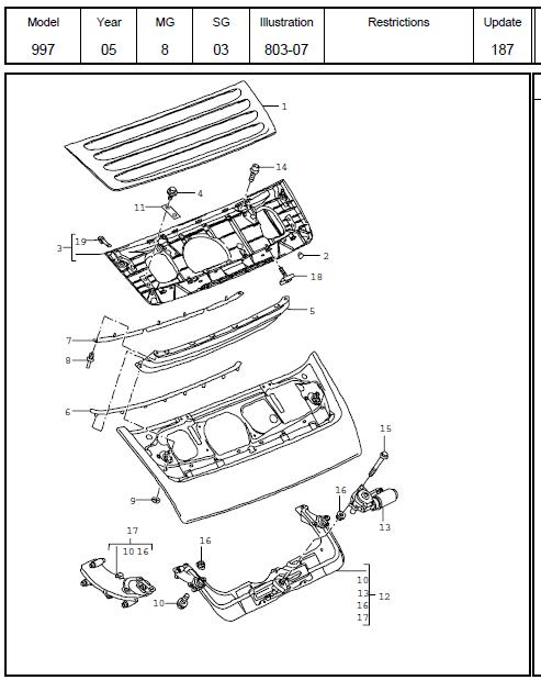

Looking to replace the wing motor.
It makes alot of noise going up and down and
just got stuck the other day. I cleaned the runners
which seemed to help.
Is this one of those all day projects or is it
some what easy fix?
Thanks for any feed back.
It is part 13 in the picture below.

Well I replaced the motor with lots of pictures. The wing
is not working right.
I had the wing all the way up and just swapped motors. It likes
only goes down about half way.
Looks like I need to remove the motor, drop the wing by hand and put motor
back on.
Any advice?
Paul

Did the motor replacement fix your problem? My rear spoiler only goes up on the right side (the driver's side will not go up). I have inspected the motor and rod/cable mechanism and it appears that the driver's side of the rod/cable mechanism (what the motor attaches to) has something broken in it. I am thinking that the motor is not the problem, but that it is the plastic housing for the rods that the motor attaches to.
