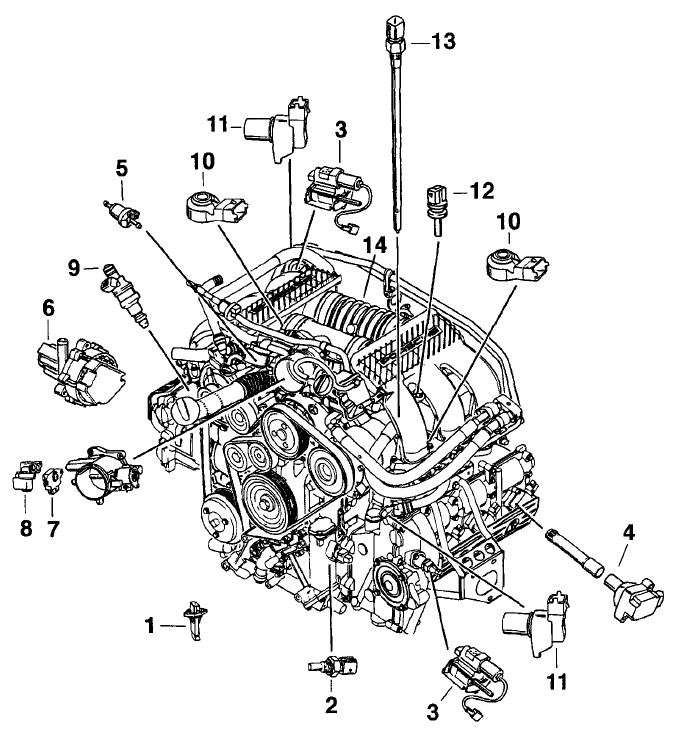

Yes, it does -- item 13
1 - Mass air flow sensor
2 - Engine temperature sensor
3 - VarioCam valve
4 - Ignition coil
5 - Tank venting valve
6 - Secondary air pump
7 - Throttle potentiometer
8 - Idle speed air control valve
9 - Injection valve
10 - Knock sensors
11 - Hall-effect sensors
12 - Engine compartment temperature sensor
13 - Oil temperature sensor
14 - Resonance flap
3 - VarioCam valve
4 - Ignition coil
9 - Injection valve
10 - Knock sensors
14 - Resonance flap
I ask because I got CEL P0197 along with some misfire codes.. Any idea what the part number might be? Thanks!

P0197 Oil temperature sensor - below limit
Possible fault cause
- Temperature sensor faulty
- Wiring harness
- DME control module faulty
Part Number: 996.606.150.00 Oil Level sensor -- US MSRP $59.98
(includes plug socket, connector, and gasket)
