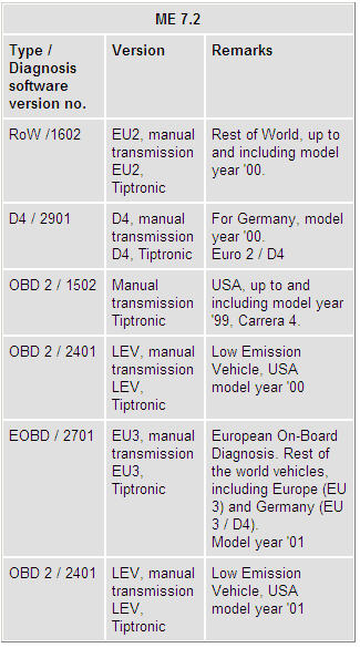

I did check on-line at PIWIS TSI, and it still shows the same fuel map list for DME7.2. I was surprised that it wasn't listed, as neither the X51 kit for 3.4's or 3.6's contains a replacement DME. The instructions I have for the 3.6 X51 kit show flashing the fuel map with PIWIS, and I would have thought it would be the same for 3.4's.

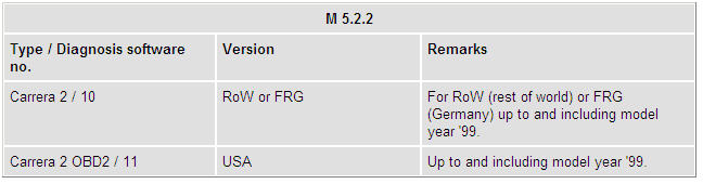

I guess it must do, if they installed the fuel map on yours, but the documentation doesn't say so. X51 maps aren't listed for DME5.2.2 (non-eGas) either. I think it must be an oversight in the manual.
