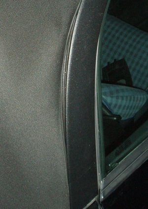

I have a 99 boxster that on the passenger side the top will not seal all the way and I get lots of wind noise and such from that side. I have tried adjusting the cable mounts but that does not seem to effect the gap. this gap is right on the curve on near the engine. Any help would be great thanks.
Here is a pic of the issue.

I got a 99' boxster and had the EXACT SAME problem.
I got it fixed for around 50 bucks. (took him 20 mins to do)
basically, the tech takes apart the side door's panel and then he READJUST the window so that it's back more so it can seal better. (you can actually do this yourself if you have all the tools, just pop the plastics out and unscrew..)
Leaks, wind noises, etc all stopped.
Good luck!
