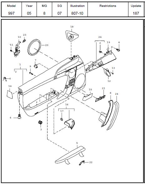

1. Disengage spring −1− with a suitable pair of pliers from the guide mechanism −2− .
2. Unclip shock absorber −3− from door trim panel −4− . Unclipping shock absorber
3. Press together guide mechanism on the right and left −2− with a suitable pair of pliers (arrow A) and disengage from the door trim panel −4− (arrow B).
Install is the reverse.
