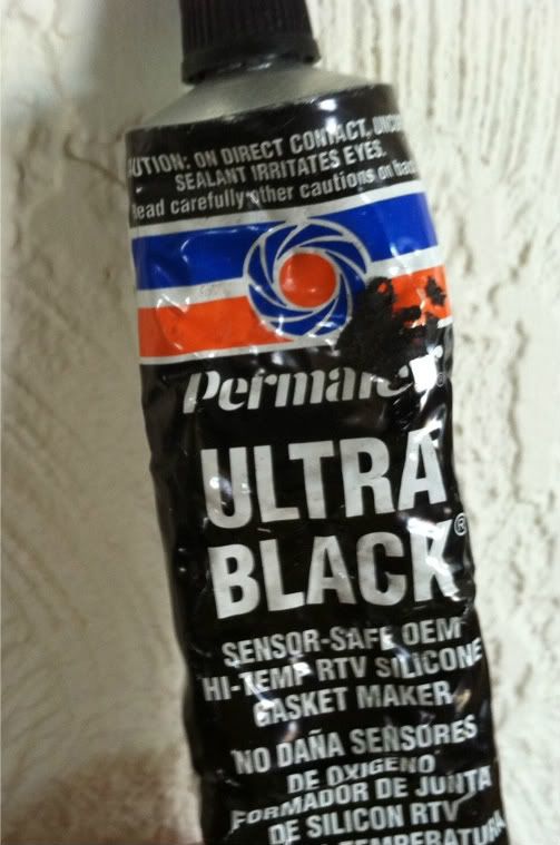

I cleaned my throttle body a couple of months ago and the gasket you are referring to literally fell apart when I removed the Idle Control Valve (ICV) to clean it. I ordered another from Sunset and while waiting assembled the unit with Permatex Ultre Black Gasket Silicon. It worked great and I haven't had to install the original gasket yet.
