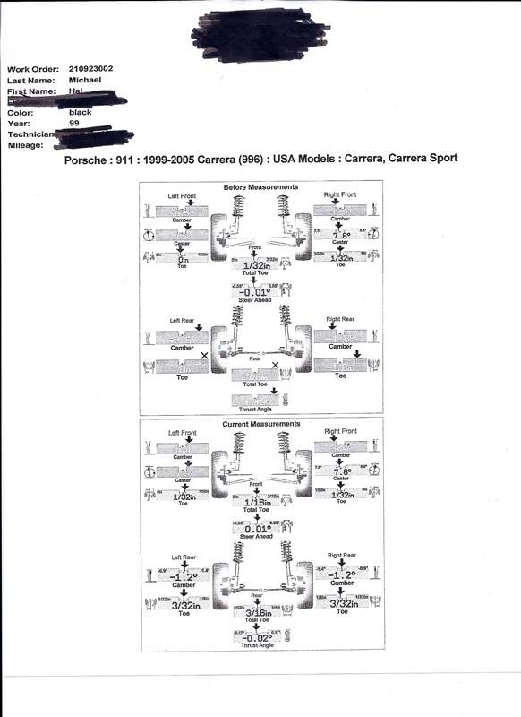

Front Left:
Camber -0.4
Caster 7.3
Toe Out 1/32
Front Right:
Camber -0.4
Caster 7.8
Toe Out 1/32
Left Rear:
Camber -1.2
Toe +3/32
Right Rear
Camber -1.2
Toe + 3/32 inch
The following sheet shows before and after.
post-72751-0-95044300-1317399585_thumb.j
You could try a little more negative camber on the right and a little more cross caster +, there is a very small margin of adjust-ability within the mounting bolt holes for caster.
Example change to front right:
Camber -0.45 to -0.5
Caster 7.8 <---- a little more positive as well if you can do it, or a little more negative on the other side.
