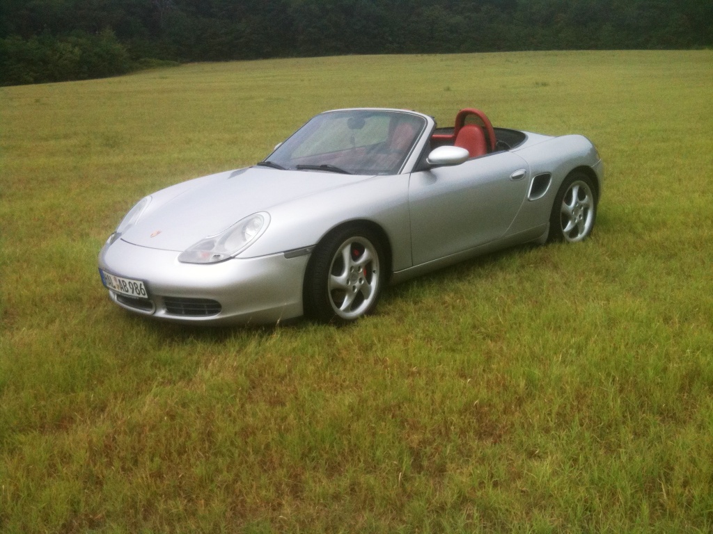

BTW, I am a newbie here. Included is a picture of my (sick) baby.
