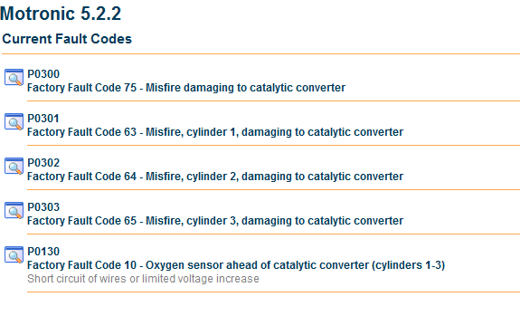

Alright i was lucky i had the cable in my car and was able to find the software - looks like the 02 sensor on the back is bad? how is that possilbe it has just been replaced?

Without knowing what the codes are, you have no idea if or when it is going to start blinking again. You don't need a PIWIS or Durametric system, any OBD II compliant scanner will tell you exactly what is going on. From your first post, it sounds like the car went into "limp" mode (the DME sets a relatively low engine RPM limit to prevent doing more damage), that usually does not happen without a damned good reason....................
If it were my car, I’d have it scanned before I did anything else. You could very well get a few kilometers down the road, out in the middle of nowhere, and it could start flashing, or worse.
Share this post
In general, bad O2 sensors do on cause a car to misfire, which you seem to have on all cylinders on one side of the engine. The O2 sensor code, however, can be the result of this type misfire event.

According to the OBD II diagnostics manual the O2 code (P0130) is an electrical fault code, meaning that the sensor is not in the correct voltage range, or is shorted. The sensor and its heater need to be checked for the correct voltage readings, and the wiring harness and connectors need to be looked at and tested for continuity, presence of shorts to ground, and the correct voltages. If the sensor fails the test, it needs to be replaced. If the sensor voltages are correct, and the wiring is OK, the next stop is check the DME, which may have developed a fault.
As for driving the car, that is up to you. Without "eyes and hands on", and electrical test of the sensor and harness, I really have no way to advise you on how to proceed. As I mentioned, I have not seen an O2 sensor force an entire bank of cylinders to misfire simultaneously, and if it starts doing that again, it would be both a very long journey and would probably cause collateral damage to the car as well......
