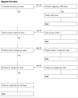

So, you reset the codes and they come back?
Then there still gas to be a leak in the system - either lines or a fitting.
Here is the diagnosis procedure...
