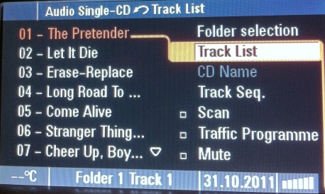

I have a PCM 2.1 (SW4.0) system which can play MP3s. However when playing a track I get the folder name, and then weird characters (see picture) instead of the artist/track name.
Even stranger is that the system can clearly read the MP3s ID3 tag because it shows the track name if I go to track list (see picture).
These MP3s were bought through iTunes or ripped from CD using iTunes. I can also confirm that they all have ID3v1 and ID3v2 tags in them.
Has anyone else had this issue (preferably with a solution)? I'm going to try burning a disk with MP3s that have just ID3v1 tags. But I don't think this is the issue as the track screen works correctly.
Does anyone know what should be shown here? Is it just the track name or should it be track name/artist?
Correct folder screen:
post-32638-0-21387200-1320166929_thumb.j
Correct track list screen:
post-32638-0-08902400-1320166948_thumb.j
Weird Audio screen:
post-32638-0-02334700-1320166961_thumb.j

Hopefully the final reply on this topic. I'm only posted now so that the solution is clear incase someone else faces this issue.
The problem was Unicode characters in the ID3v2 tag (which is a ID3v2.4 feature). You can actually fix this in iTunes by selecting the track, right clicking and selecting "Convert ID3 Tags". There is a tick box for "Reverse Unicode" which will make sure unicode is only used if requried (because the track title, etc has non ASCII characters such as chinese symbols). You can also specify the ID3 tag version. I believe 2.3 doesn't support Unicode so will be the most compatible with PCM systems.
