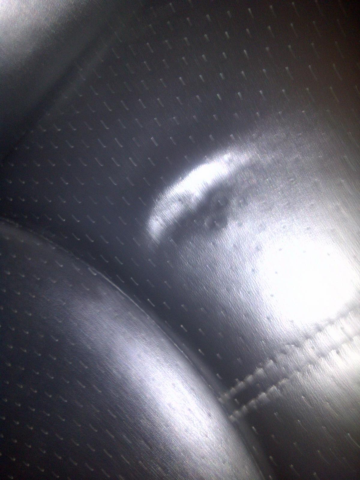

I just had my passenger seat cover ruined by a careless dealer tech who repaired my cup holder under warranty. Apparently he had soemthing in his fat A## back pocet that pressed and 2 inch permanent "dent" in the leather (see picture). When I picked up my car i saw the damage and said WTH? My service manager said he would take care of it.. Then his boss tried to tell me it was "normal" wear and tear and wasn't their fault.. I take IMMACULATE care of my car and know where every flaw is.. I tore into this idiot like a wolverine. Not a blemish on the drivers seat but the passenger seat has worn???? Needless to say they agreed to replace the leather seat cover..We'll see how it turns out. I'm not the most "easy going" guy when it come to my P car....
post-7267-0-92464300-1329852583_thumb.jp
Share this post
They probably will use a heat gun and workout the indentation.
They replaced the leather seat cover on my insistence. The only problem is that I have one new seat bottom and the rest of the car doesn't match. I need to get my wife to drive with me more to get some oil in the leather. Just that seat cover (bottom) is $1000 by the way. Gotta love Porsche.. Also gotta love my warranty too. Although the idiot tech did the damage the dealership managed to get my warranty to pay for it.
