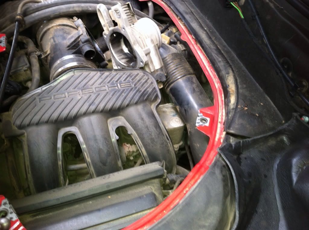

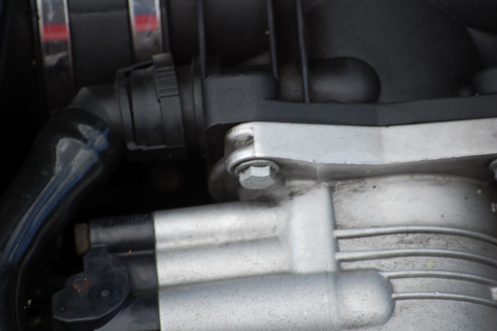

I'd plastic, and tape off the passenger compartment. Make sure the motor is not hot (don't want cold water on hot alternator diodes as they will be damaged)
before
post-74750-0-63874900-1324403647_thumb.j
after...
post-74750-0-68118000-1324403664_thumb.j
sorry for the crappy cell pics
