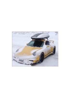

Hey Api sorry I'm late. Wrong approach all together. I'm in NH. Most of your driving will be on dry winter roads. Stick with 19" wheels and go with 235s up front and 295s in rear. Only Pirelli makes the right tires for this set up, Sottozero Series 2. They are N rated. The car will handle much better in 95% of the driving you will do. I also have a C4S and it does great with this set up in all conditions except heavy slush when you might as well waterski. The 265s might do marginally better but you are still going to have a really loose *** end. 18 inch wheels are harder to re sell and I think the feel is a little .. soggy for lack of a better term. I have the wheels on now. Since you are in the area you are welcome to come give the car a spin if you like.
post-89070-0-77895300-1386544926_thumb.j This picture was taken at Saddleback Mountain in Maine. This is a Porsche snow plow ;-}
