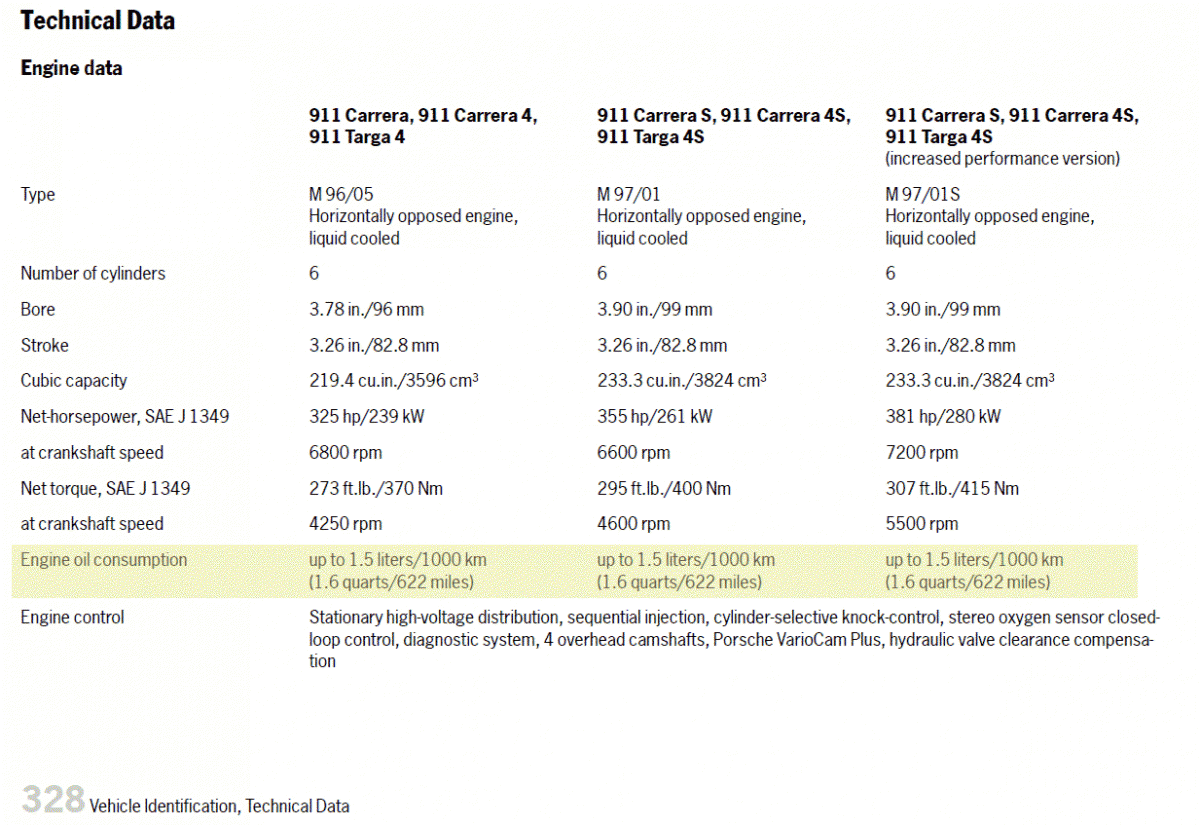

Well...Here you are...It is normal.....Right from the Owner's Manual for 997's, And it is the same for 996 as well:

Good news!
Thanks for the information.
Disagree. "Up to" 1.5 liters per megameter is legal language to protect the manufacturer. Two quarts of oil to make a round trip from SF to LA? May as well replace those fouled plugs too!
Let me make sure I have this right... 24 quarts of oil added between oil changes is considered "normal" per the owner's manual... You are okay with that?
