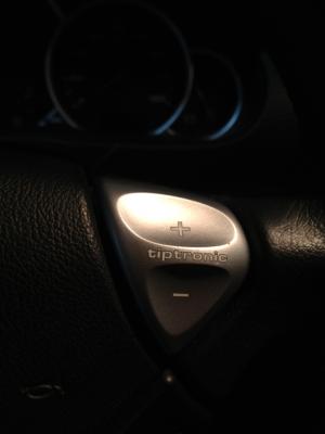

I have an 05' Cayenne S and I think the right paddle shifter broke as it keeps pulling up on the right side. I'm guessing that I need to rmove the steering wheel face cover (horn) to replace it. Does anyone know how to do this or can you provide a diagram how the steering wheel face cover (horn) comes off? I quickly looked around but didn't see any obvious screws.
post-11403-0-07426000-1328670459_thumb.j
unfortunately there are no repair parts for the MF Wheel. you will need to replace it. To remove the "horn" remember its actually the airbag = explosives. Your best bet is to try to get one from a breakers or try ebay.
