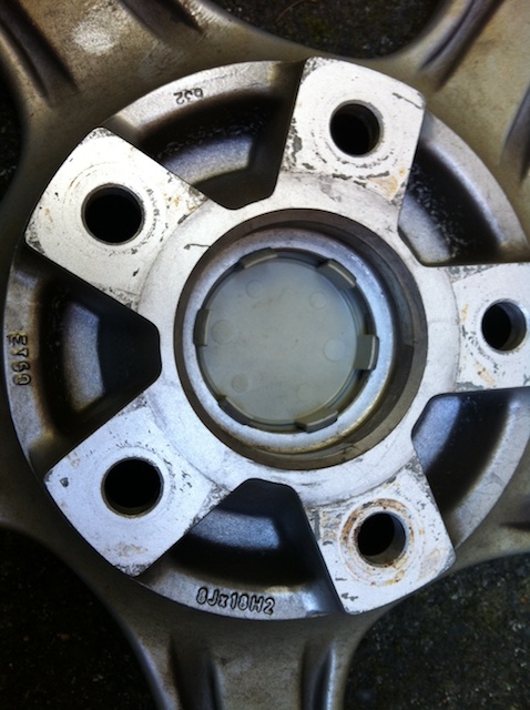

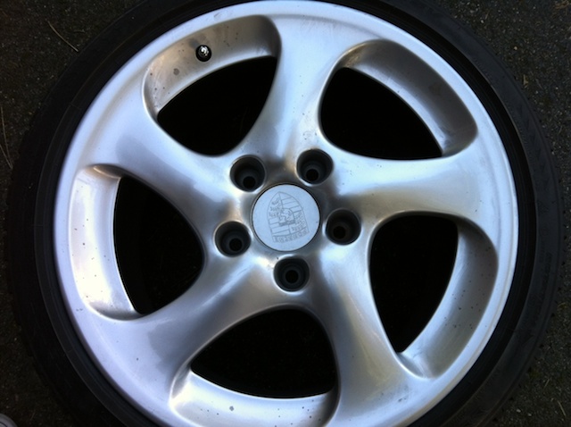

If I'm not mistaken those look like stock C4S wheels and the tires are sizes that would be normal for winter tires on a 996.
The best thing you could do is post the wheel sizes (we can see that one is an 8JX18. Are they all the same?) and also the offset of the rims (50, 55, 60, 65 or whatever they are).
With the offsets people should be able to tell you a bit more.

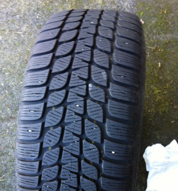

The tires may not be worth much with one having a screw in it and one having that gouge out of the sidewall.

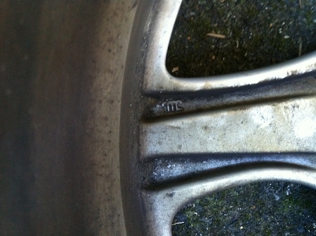

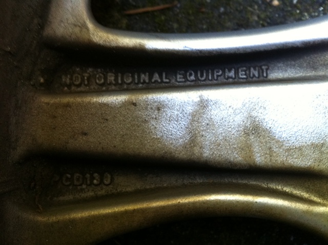

Blizzaks are very hard to get in larger C4 correct sizes. That said smaller are often used for winter. They look like aftermarket rims. See "Not Original Equipment" molded inside of spoke in 2nd pic.
$400-600 for the set depending on the date stamp on the tires. Over 8 years old would be suspect, over 10 toss them.
http://blog.tirerack...re-they-too-old
That cut would not bother me if no cord shows in the "scuffed" area. The rib on the tire is there to provide some protection for the rim. Pull the screw and if it goes through patch it from the inside and run them in the winter.
And for all of OMG if you patch it you have to cut the speed rating in half! Just how fast do you drive in the snow?

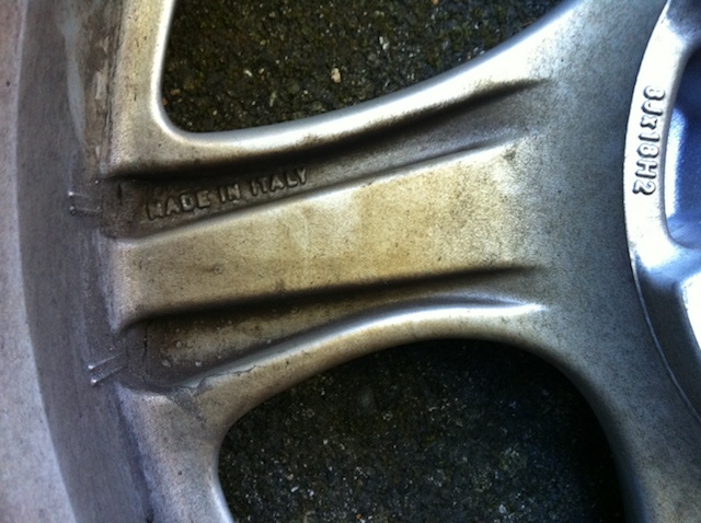

These look like Italian made replicas of Turbo Look II wheels. These are the solid spoke wheels, not the hollow spoke version found on the turbo. They were obviously used as winter wheels by the previous owner because of the Blizzaks. Also, it's important to note that the proper wheel size for the 996 C4S for winter rear wheels is 10x18, not 11x18 like summer wheels. As mentioned above, you won't find 295 width winter tires to properly fit an 11-inch rim.
I see that one of the wheels in the photo is marked 8x18, which is the proper size for front wheels. What size are the back wheels?
For some additional reference, I purchased a set of "as new" OEM takeoffs from my local Porsche dealer for $500 without tires. Since the wheels you have here are replicas and have some wear and tear, I'd think $300 would be a reasonable value for them if they are straight and not bent at all. I wouldn't plan on any profit from the tires. They're not N-spec and they are obviously not in great shape. I'd keep them on as "wheel protectors" during the sale process.
