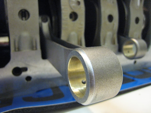

Copper/mag perhaps small rod bushes and some other components, but would I be concerned at those levels? I doubt it!
