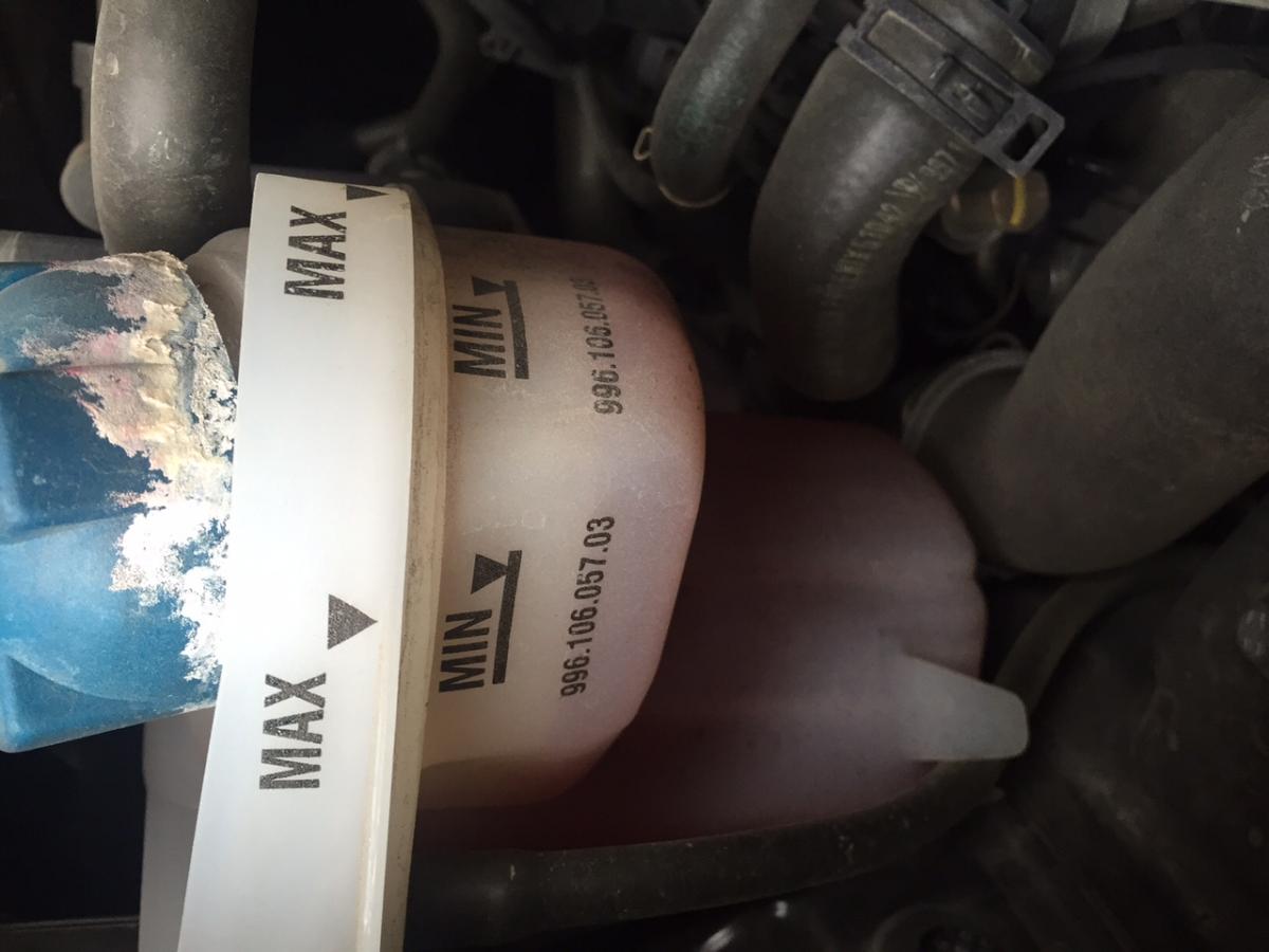

Looks like the coolant on my 2007 has run below the 'minimum level' (see pic). My questions:
1) what is current recommendation for low coolant? Is it ok just to add to it or do I need to do some sort of 'flush' as described in this thread and if so how do I do this myself? I don't need to take this to a dealer right?
2) for coolant type should I buy the one on amazon in this thread and mix with distilled H2O? Is it a 50/50 mix at room temperature to add?

If that is a photo of your coolant tank? - if yes, then you have a leaking (badly) cap and it should be replaced. They are not expensive.
Use Porsche or Porsche compatible coolant with distilled water 50/50 mix is best. Looks like you do not need much.
A new cap is a priority, this one does not hold the predetermined pressure and is probably the cause of the coolant loss.
