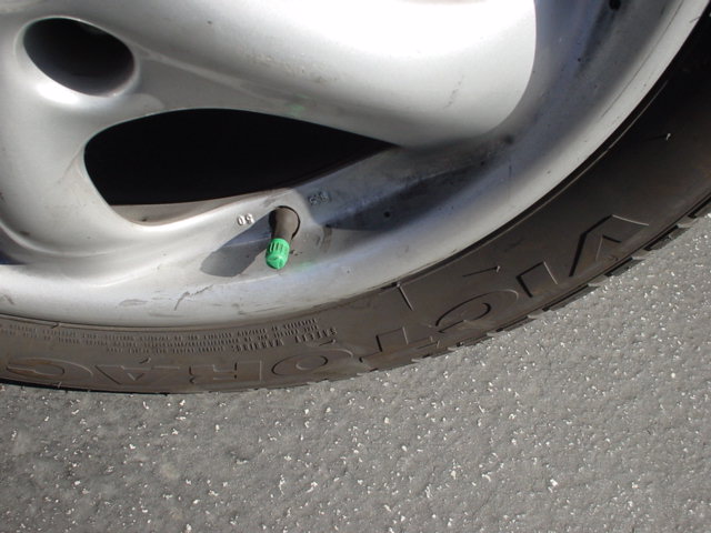

But I saw this Boxster at a tech session with green dust caps on the valve stems. The owner bought tires from Costco and said that they use nitrogen and put the green cap on, and it does not cost any more money.
I'm glad the SUV in front of me with tires from Costco has the green cap. :P
I am not going to debate the use of nitrogen in a street car.
Up here in Oregon Costco fills with Helium and gives us blue valve caps. The ride is quite uplifting... :jump:
