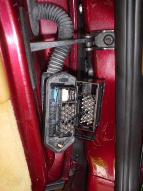

(text) It sounds like a defective door lock mechanism on the drivers side. Also the early Boxsters had a problem with water getting into the connector on the A-pillar to the body from the door and corroding the wires. I would check the wiring there first before I would condemn a door lock mechanism
tnks.
has anyone a pic of this "A-pillar" ?
and where are these wiring to check? (door/body)

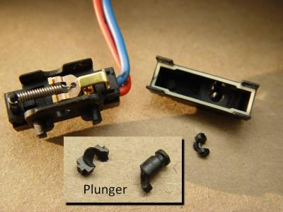

Your problem would appear to be the microswitch in the door lock assembly which senses if the door is open or closed. If it is stuck, and the alarm module thinks the door is closed all the time, then the window will go up as soon as you release the handle.
This is the offending item, but it isn't available as a separate part from Porsche. I believe it is a Burgess microswitch, but I can't find a part number for it.
post-4000-0-76113600-1339339015_thumb.jp
(Photo courtesy of another RennTech member)
