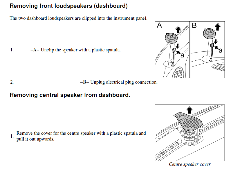

Can I get some advice please on how to remove passenger side front radio speaker grill on top of dash or alternatively how to stop rattle. Thx.
Sorry--should have added 2007 GT3
Thanks Loren--your advice last year on how to remove the dash heater vent cover worked without a hitch but that corner of the dash is rattle city. So if the tape doesnt work how do I remove the speaker grill? Thx.
There are two screws that hold the center speaker in once the grill is removed. If you have noise there I would put a little eflon tape under the screws.
I sorry I wasnt clear--its the grill cover over by the windshield pillar.
J
On the dash? if so, then the first diagram are those speakers.
Or do you mean a door speaker?
