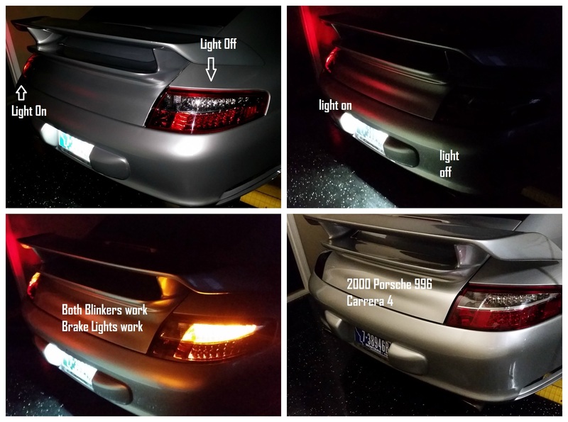

I do not mean to bring this up from the grave but I purchased the ebay tail lights and they look great and work great except for my passenger side parking light. It comes on but is is very faint. I know people spoke about a resistor. Where do I purchase this resistor and how do I install it? I have been googling all night and this is the closest I've found to an answer.
Thank you
Edited by arfnsx
The resister is typically added to aftermarket LED turn-signal lights to increase the load in order to avoid "hyper-flashing" when the LED blinks too quickly.
If you have a dim parking light, then adding the resister is unlikely to rectify the problem.
