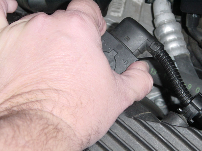

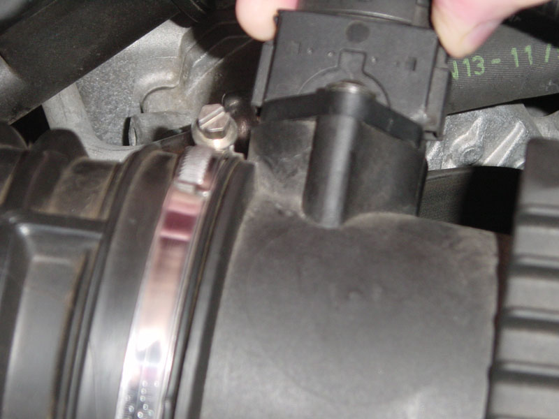

If it is not too tight then you might get it off with one hand (as in photo 1). If it is on tight then grab the other way (photo 2) and then pull with the other hand while squeezing.

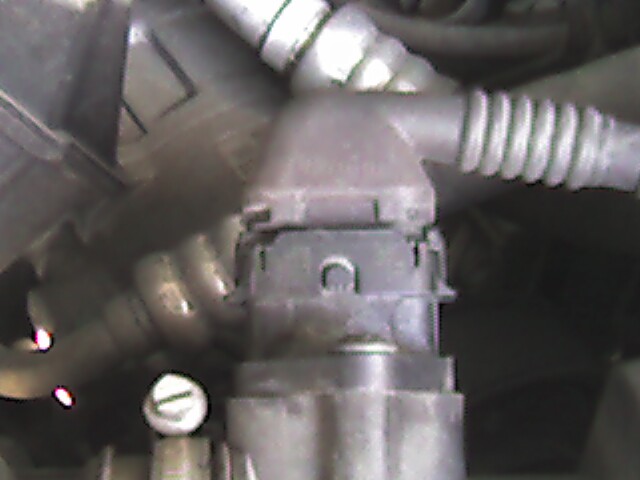

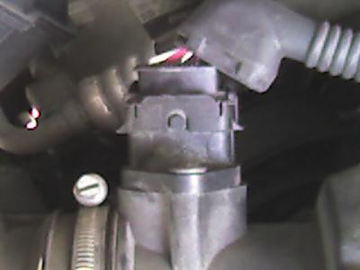

Loren, I tried this...I have no idea how this is supposed to come out...the only thing I was able to accomplish was to unscrew it and pull it out...I have a 2000 MY C4...and the MAF looks different than in the photo. There's a rubber boot and plastic but without the screws, nothing pulls out.
My neck is sore, btw. I have no idea who designs this stuff, but it wasn't designed for "serviceability"...that's for sure! :beer:
So those little tabs sticking out on the sides don't push in or pull out?
That's what I thought too...but they don't seem functional. I've tried gently pushing, squeezing, pulling. Price to replace is around $300 for a new MAF? Was afraid to break it. Once I had removed the entire unit, I still didn't see a disconnect point. It looked more like a single piece? Beyond my abilities! But then...I'm a simple man....

I just had the same problem on my brother's 2000 C4. See the attached. The button is on the underside.
Wow, I fiddled with that thing and could feel it underneath...why on earth would someone design the clip so the button isn't visible? :cursing:
