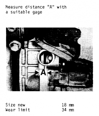

Is there a way to test is the clutch is good while driving?

You can measure the clutch disk through the inspection port.

Thanks guys. Which corner of the car should I jack up to access the clutch inspection hole? Sorry, I'm a newbie with 951 and obviously don't have access to the car yet.
Share this post
Left side as viewed from the drivers seat facing forward.

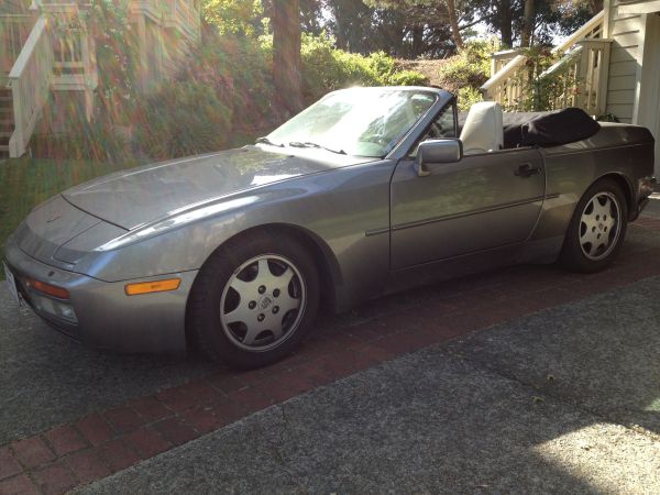

Brought the car home today. It drove great. Clutch is good and timing belt, rollers and water pump were done in 2003 and 23,000 miles ago. Think I am due for new belt still? Car is garaged and pampered in CA.
Share this post
Congrats fella. I almost bought one of these about ten years ago. I would still change out that timing belt and carefully inspect everything due to age.
Share this post
