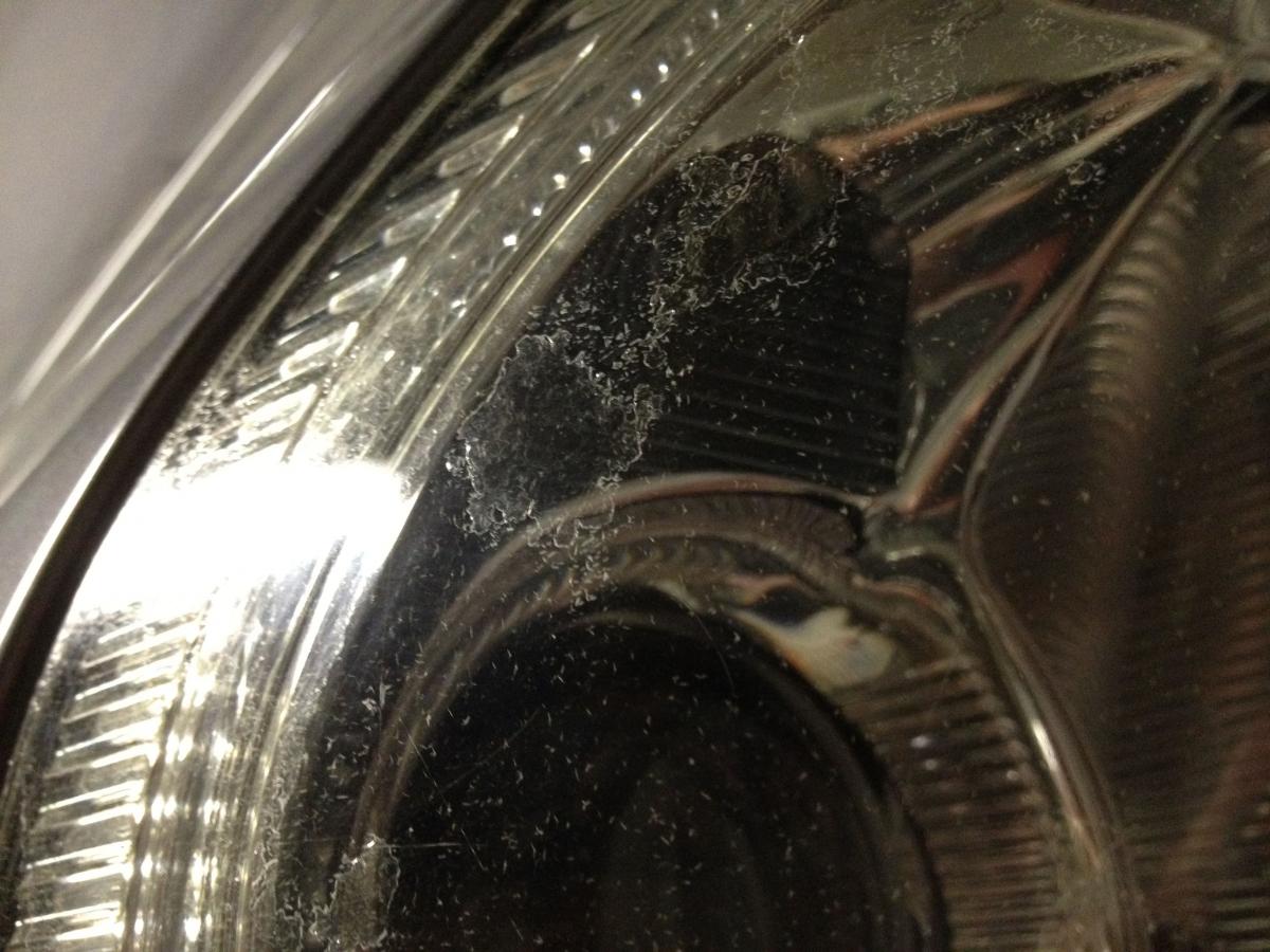

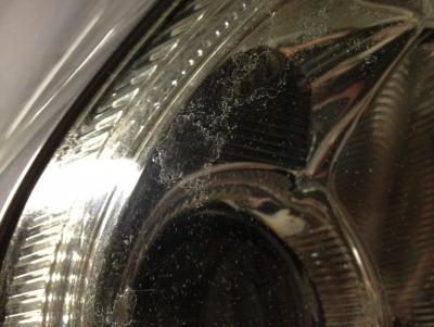

Hi,
I've just noticed that the surface finish of my 2004 C2 996 headlights have a bunch of rough spots, and in areas almost looks like a surface coating is peeling away. Any advice on how to fix this issue and restore my headlights?

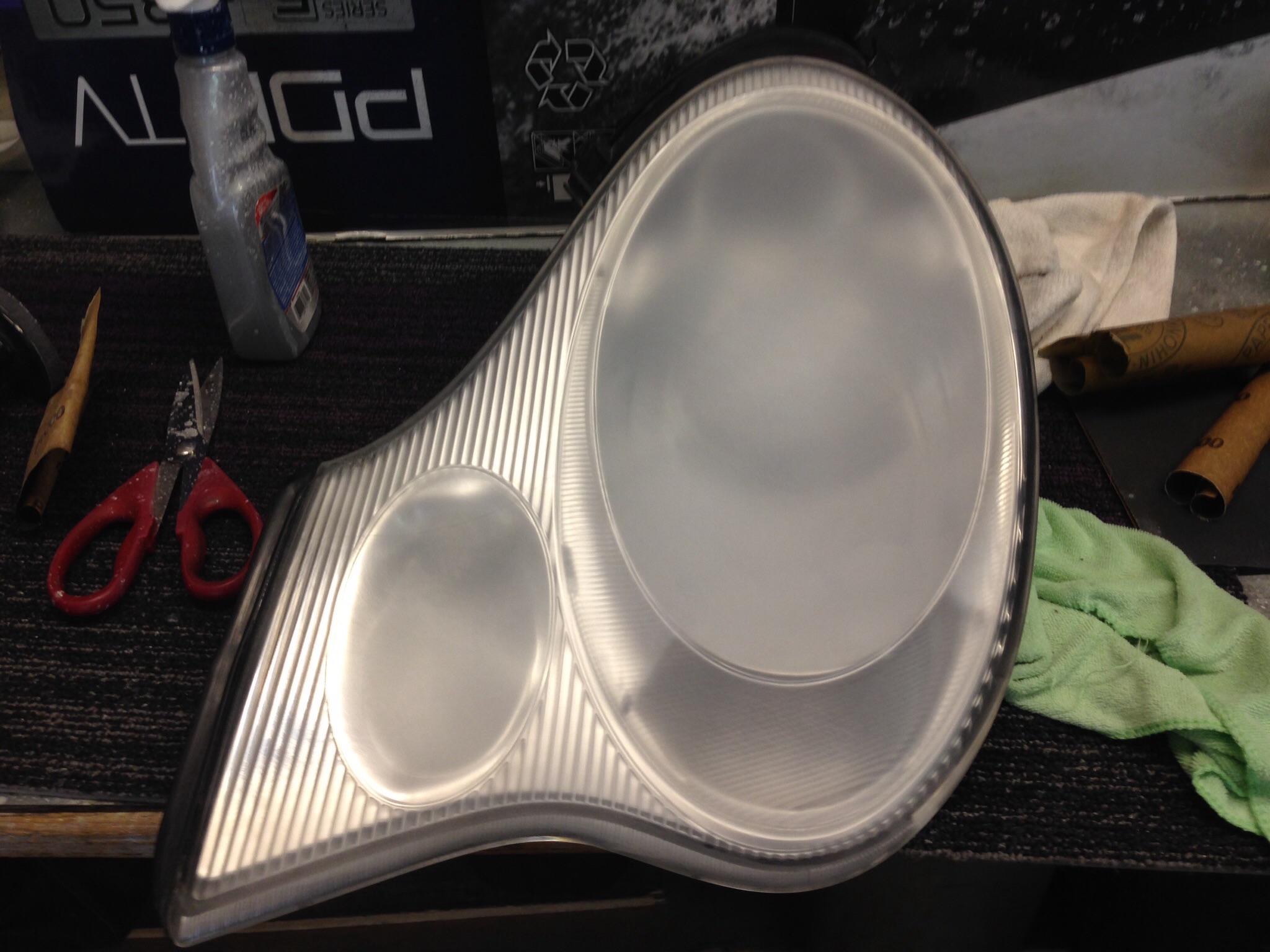

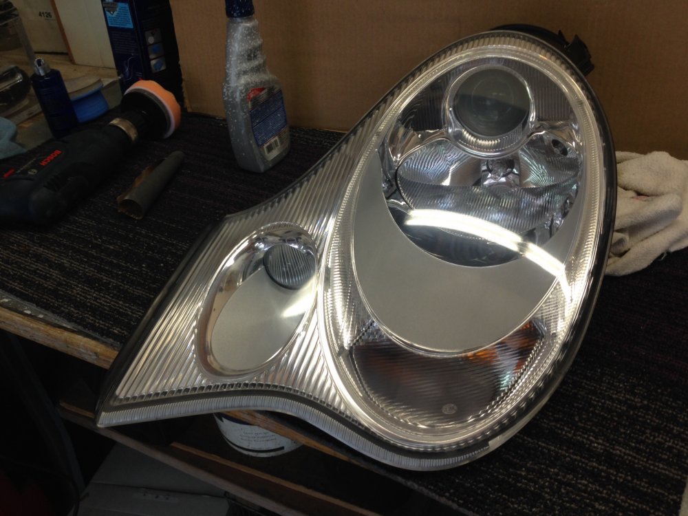

Those will clean up just fine. My process is to dry sand then wet sand. Final step is polish and re-clear. The kits in the store will work pretty well. The failure point of the kits is the sealant or coating. It will not last very long. Once you abrade off the factory UV coating it will yellow and haze eventually. I use actual clear coat on my clients lights...and my own 996. Give the kits a try.
I would promptly refinish the headlights and put a clear bra type product on it that shields it from UV. i had Premier clear bra guys refinish my headlight and do a cover. There are other pre-cut solutions available.
My 996 has just had the second refinish and I am very pleased. Take them out and go to a really good body shop that specializes in high end cars and have them tell you how thay would refinish them. They need to polish them, then fine polish to a near perfect and smooth finish and then the most important part is to have them clear coated just as it came to you new. I had them polished and did not have them clear coated - nobody told me to - and within 3 - 4 months they were in the same condition and you can only polish them a few times. Do it right the first time and use a professional body shop so as to get the clear coat done properly. The best thing you can do is to raise hell with anybody and everybody at the NTSB and maybe they can get the OEM people to offer replacement lens at a reasonable price instead of having to do the polish or worse yet, replacing the complete assembly. This will continue to be a problem until manufacturers and made to change a terrible product. Surely they love the resell especially Porsche which gets near $5000 for a new set. Look around at all the cars out there with this problem and 98 percent of them are going to do nothing about it. Ed ibay@earthlink.net

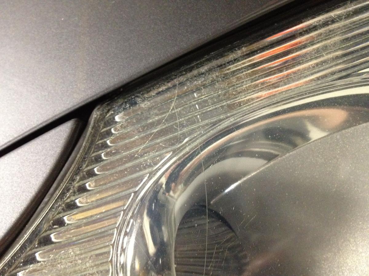

Resurrecting an old post.  Have the same issue on an 2014 model.   I applied some tape to my headlights to "protect" them during a DE event.  Removing the tape after the event apparently lifted off sections of the UV coating so now I have multiple defects across the headlights.  Will the sanding kits remove the remaining coating so that I can apply a real clearbra or Xpel type product?  Thanks.
