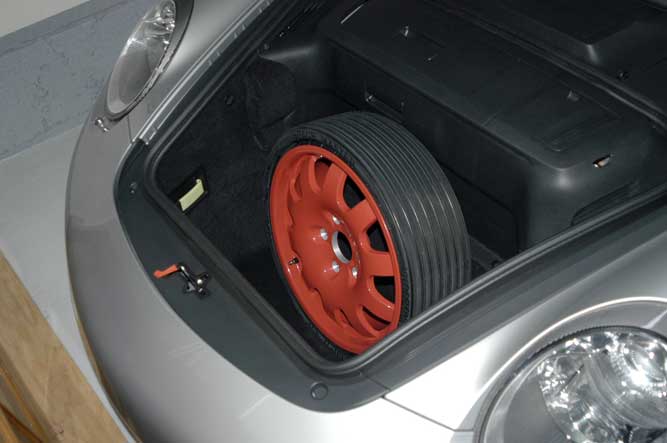

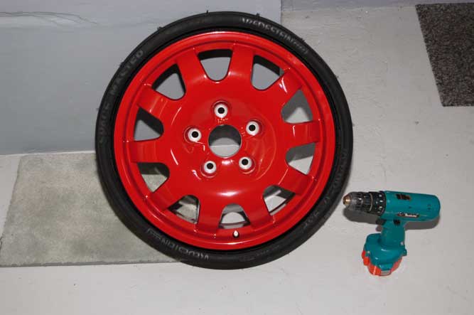

I just received Porsches OEM aftermarket spare for the 997S just a few days ago and from what I was told it is supposed to become an option for the 997 and 997S. I have a 997S and it does fit in the trunk but I am still waiting for the jack and the kit to secure the tire. Talk to Jeff at Sunset Porsche (ask for parts dept) in Oregon (1-800-346-0182) and he will set you up with the whole kit minus the compressor which you already have. The complete cost including jack is around $700.00. This is probably the same spare tire (collapsable type) that a 2004 996C4S has (the rim must clear the turbo brakes on the S model). The rim is alloy and painted red, its made in Germany and the tire is made in Holland. Remember your adding about 30lbs+ to the front of the car and reducing the little trunk space you have to more than half but for some like myself its worth the "peace of mind" especially on long trips in remote areas. If you have faith in the "liquid bottle" then its not for you and would simply be a waste of money. I've already pumped the tire up and the diameter of the spare when pumped matches the diameter of the 19" stock wheels so it should work. Also the rim is deep enough to easily clear the stock "turbo" brakes and the wheel lug bolt pattern matchs. The part number for the spare tire is: 996.362.020.02 Other info: max Psi is 40lbs, size is 185/60/17 93 P, DOT DVKV 4103. Stamped inside rim is: FR=6200N , GK AlSi7, Made in Germany, and the part #996.362.120.02 Please note that the part # stamped on the rim of the tire has a "1" in the 7th didget, not a "0". This probably represents the tire itself and not the kit? You will need to talk to Jeff regarding that. I will try to attach a few photo's. Cheers.

I also have Space saver spare (with same tire size "185/60/17" but my space save (collapsed) sits 21" tall and the back wall in my trunk (2007 997 C4S) is only 20" tall but in your pics the spare seems to sit way lower??
