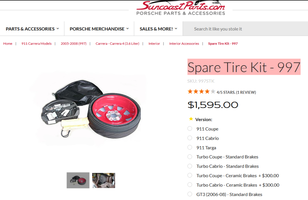

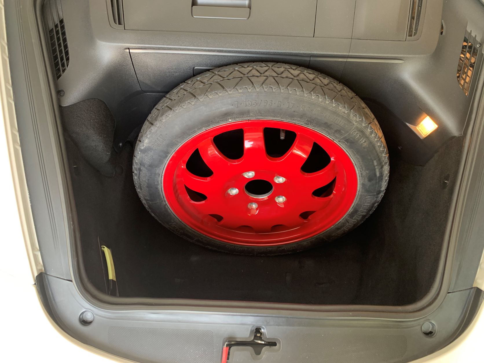

4.- Another alternative: I bough on eBay an spare tire with the Porsche OE jack kit (from an 996) and I placed (fitted) in my frunk, together with a HF torque wrench, rubber globes, small foam knee pads and some rags. Be aware that for the 997S (with 19" wheels and bigger brake calipers), you will need to add also a 5 mm spacer (for front wheel) and a set of longer bolt lugs, so the spare tire won't rub brake calipers. I tested it in my 997.1 C2S cabriolet and it worked fine. Of course, with this option, frunk space is almost gone, but for the occasional trips that I do with my wife, the back seats are then used for small luggage below/above the folded backseats, and was enough for our weekend trips to nearer cities. Be aware that if this option is used, you will end up with a huge wheel in your backseat (as won't fit in the frunk), so luggage must be moved there to make space behind the seats for the replaced wheel/tire. An extra item: add a garbage plastic bag to cover the wheel in that case so dirt won't land in your carpet or seats.
