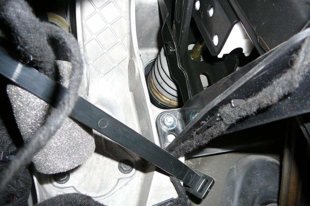

It's been a while, but I have an update on the squeek / hiss I was getting as the brake pedal is released.
I did check the vacuum line and booster pump, that does seem relatively common for causing some issues. I had thought that perhaps a split and weak vacuum was causing what I was hearing in the cabin - but no, everything was in good shape.
So, I removed the panel in the cabin where the pedals are and with the engine running - and it took a while to locate - I identified the culprit as the rubber boot that surrounds the rod that the brake pedal depresses. To elaborate: the boot is fixed to the end of the rod that is closest to the pedal, and when you push it in, it collapses the boot like an accordion - as it should. However, when I released the pedal, the other end of the boot pulled away from the back wall also, and as it did, a hiss and squeek would be produced.
It is hard to access, but if I worked my hand to the back of the boot and just squeezing or moving it a little would produce the same hiss. It didn't make sense for the boot to move at that back end, so I pushed the base backward. I believe that the back end of the boot had come loose, and sliding it backward remounted it - although it probably only moved back maybe 5mm.
Once done, when depressing the pedal, the back of the boot is now stationary, and it collapses / expands as it should - more importantly, it instantly eliminated the squeek and hiss.
I'm not certain how long this fix will last, or if the boot coming free is a sign of something else (my brake booster pump was getting fairly hot - weak vacuum, but not enough to trigger fault?), but for now, the problem I originally posted is resolved.
Picture of the boot attached - hope this helps if you are experiencing anything similar.
Mark
