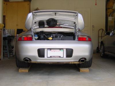

I change the oil on my 996 by backing up onto 2 - 2 x 10 boards. It gives enough clearance to drain oil and change the filter without putting the car at an angle where oil will be trapped.
I have jack stands and ramps - but this is much easier than fooling with either of those.
Thanks guys, all very good input from all responders. I think I will take a page from Loren and Dharn's book and go with the "board" method, allowing me to be both lazy and able to keep the car level.

I changed the oil yesterday using the "board" method and it took under 10 mins (not counting drain wait time). No ramps, jack, or jack stands needed. Very effortless -- exactly the advice I was looking for.

I took Loren's 2x10 (or are they 2x12's ?? ) method but have 4 separate boards,(doubled up) that is, I cut a long board into 8 different sections , then used recessed bolts and Gorilla glue to fasten 2 of them together. Each is about 2 feet long , and the front is cut on an angle so the tires rollup easy, they work great, and take up less room for storage. What do you think Loren ?
