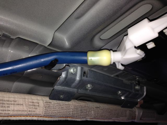

I took out my headliner because it was sagging. While is was out i checked all 4 sunroof drains and found them clean. But i have water marks on my headliner. So now that i have a clear shot of the interior roof and the sunroof mechanism, i was able to see the leaks.
I poured a bottle of water on the sunroof and it started dripping out over the rear seats. I take it the actual sunroof seal is not doing its job. Turns out the seal is letting water drip through and the channel is lower than the drain. So it just drips. Hopefully pictures can describe better than me.
I hope the photos make it clearer -- I can't envision what you're describing. The sunroof has a sort of dam around the inside opening. This is supposed to capture any water that gets past the actual exterior seal (and some always will..) and channel it to the drains where it drains off to the ground. My drain looked fine from the inside - it was plugged up in the bottom of the channel the dam makes.. ie - outside. Could only see this by standing up in the truck with the sunroof open, and shining a very bright MagLight at the drain location. Then I saw the crud blocking it.
The water would fill up the drain part of the dam and when it got high enough flow over the lip into the interior of the car. I'd check this before looking at replacing the sunroof seal itself (which is going to be an ugly and labor intensive job and isn't likely to solve your problem.)

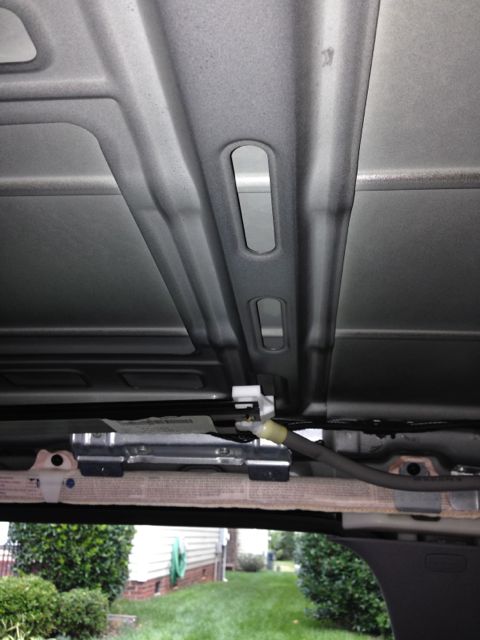

So here are a couple of snaps. I have my headliner out if anyone needs a specific shot of anything just ask.

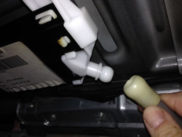

At the back of the sunroof frame is a drain. It has a bit of a reservoir then the tube to the back of the car. I sat inside the car while a buddy with a hose sprayed the roof of the car. No water came in. So i moved the car onto an incline and water started to drip. (Don't park on an incline, is the only answer i can come up with)
If the reservoir gets too much water then it will leak over the frame and onto your headliner. I am going to go full black alcantara for the interior of the PIG. So more pics will follow. Interestingly one of my drain tubes is blue. The others grey. Carfax was clean, so no real idea as to why this was changed. Although when it rains and rains i have water when i open up my rear drivers side door.

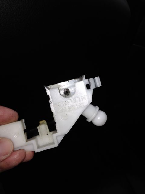

Attached is a picture of the plastic piece where the drains hook up to. I wanted to make sure this was 100% clean so i took it out. You can see the factory sealant that was displaced when i removed it.

Good photos..
The kink in the blue hose - last photo - sure could cause some backup, especially if some crud got caught in it. You might be able to straighten it out if you can get the hose out of the fitting and shorten it by 1/4" or so - or use some coathanger wire and electrical tape to make it run straight. Is that the side that's backing up? And have you blown out the hoses?
I do seem to recall mention of these hoses (which I believe run down the C-pillar) coming disconnected about where the rear-hatch struts attach in the roof, apparently there is a joint there..
