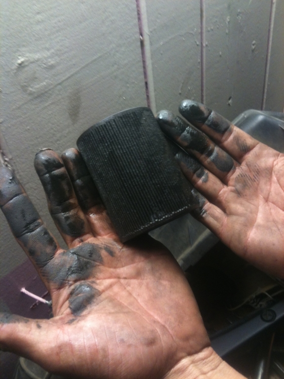

Had fuel pumps changed recently along with fuel filter. The 2005 CS is at around 85Kms. I don't know if the fuel filter has been changed before. Here is a pic of how dirty it is (by looking at the gloves). From the picture, looks like fuel enters the filter assembly from the two fuel pumps into the two "side" nozzle things on the yellowish "cap" and comes out one outlet that is in the middle of the cap. From what I have seen by just googling, I don't think you can buy the filter element by itself... just the whole assembly.
post-88071-0-81169000-1370283253_thumb.j
The residue on the gloves is actually darker than the photo shows.
Edited by Ricky1

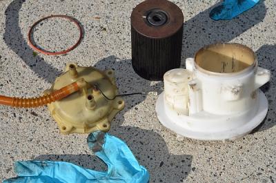

Can I just purchase the fuel filter element and replace that? Is it the same as the element in a touareg/Q7? What is the reason the entire fuel filter housing needs to be replaced? Also is the VW part number (7L6127434) the same as what's used inside the Cayenne filter assembly?  thanks!

I just did both fuel pumps FPR and Filter.  The Pelican tutorial is very good, and you do not need any special tool.  The retainer ring is very easy to remove with a few taps with a screwdriver and hammer.  The sealing ring is difficult to seat with little room.  Just make sure your fuel lines are zip tied up out of the way of the fuel gauge bobber.  I did not do that and had to go back in to allow it to raise all the way.  Not hard to do.  The carpet has pre-cuts to follow as well.  Just be sure and have all windows and doors open for air and unplug the battery after you disable the suspension control, (pull the fuse) unless your on a perfectly level location.  When I plugged my battery in, my suspension was way out of whack.  That took 100 times longer to fix than the fuel pump replacement.
