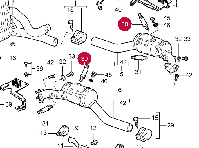

996 cats
997 cats
Odd. My 996 cats have the 02 sensor plug locations like it is in your 997 drawing. Did you switch the diagram label?
I wonder if the shapes are the same (and length of the pipes) despite the 02 locations
The images are for 3.6 liter cars and they are not switched.
997-1 and 996 (3.6 liter) are the same engine - so other than tailpipe location (body design change) they should be close. There were changes to the DME but the O2 sensors are the same part numbers.
I went through this when replacing my cats earlier this year. The O2 sensor location was changed between MK1 and MK2 996. Prior to 2002 the second oxygen sensor is near the muffler clamp, but in 2002 it was moved to the top of the cat. The physical dimensions for the cats are the same. Aftermarket catalytic converters often come drilled out for both. I'm pretty sure either would fit, however the O2 sensor leads have to be extended if you switch from one that has the O2 sensor at the cat to one that has the O2 sensor near the muffler clamp.
