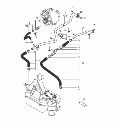

wher does the hose no 1 goes and where the hose no 17 come from all i can see is the two hoses connected
to oil housing/cooler ?? but i cant see the others where are they connected two
Edited by redzero
where does the hose no 1 goes and where the hose no 17 come from
