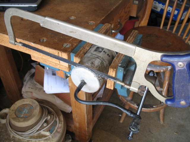

As I said a few years ago it is large. Largest fuel filter I have ever replace on any vehicle. My 1997 Boxster filter with 67,000 miles on it was finally replaced only because the Box was on a lift for a clutch replacement.

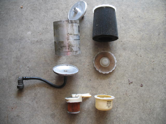

I cut the Box filter open and there was no junk inside it.
Then I cut open the tiny white plastic filter at the bottom which came from my 1988 Toyota pickup with 151,000 miles on the filter. Nothing in it either.
