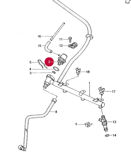

Item 7 is the pressure regulator. Remove the hose and spring clip (5) and install the new reulator with new o-rings (3 and 4).
Re-seat the clip and re-attach the hose.

I just tried to replace my fuel pressure regulator on a 1999 986 Boxter. I found that I was not able to remove the retaining clip because the air filter housing was in the way. How did you get around this? Do you have an after-market air filter? Please advise !!
Remove the air filter housing if it is in the way.
