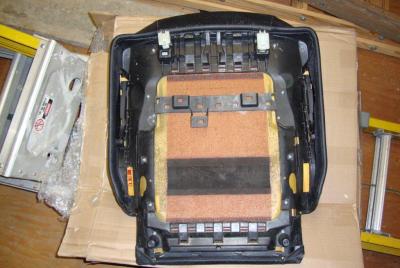

This is what the bottom of my 2003 sport seat looks like. see pic
You can probably take your seat bottom out by releasing the two white nylon clamps.
Then unscrewing the screws on the switch side panel to allow sliding it through the hole, unlatching the big connector from the cushion bottom base (1/2 turn should unlatch it) and taking the seat belt wire out of the guide clips on the base.
Before you do this put the key in the house and don't bring it back out until the seat belt wire is hooked up again. If you don't do this you will inadvertently turn on the car and light the fault light = trip to the dealer to turn it off.
When you have the bottom out you will see the netting that supports the seat cushion. Not very expensive or hard to replace. On this seat the upholstery slides off the edge to release the cover and the nylon pins push through to release the foam.
Have fun and don't get dirty!
