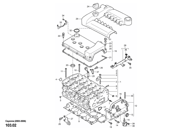

Would it be possible for you to post a diagram of where these are located on the engine and part numbers? I think I could fix it from there if I just knew what I was looking for and where its located. Thank you so much!!!
Thank you for the diagrams, I checked the Filler Cap and it appears to be on tight, I also replaced the turbo breather pipe that is located behind the manifold (part number 948 107 215 52) becuase that was broken. I can't seem to find any other leaks in the system. I dont want to keep replacing hoses if they are fine becuae those hoses are much more expensive than they should be... but its a Porsche so it doesn't suprise me.
955-104-287-01 Sealing ring -- US MSRP $7.58
You might have to take the cover off to replace it easily.
I purchased the Sealing ring, but i cant figure out where it goes, i can only find it referenced in the V6 engine. post-74057-0-49386900-1350316646_thumb.g #32
