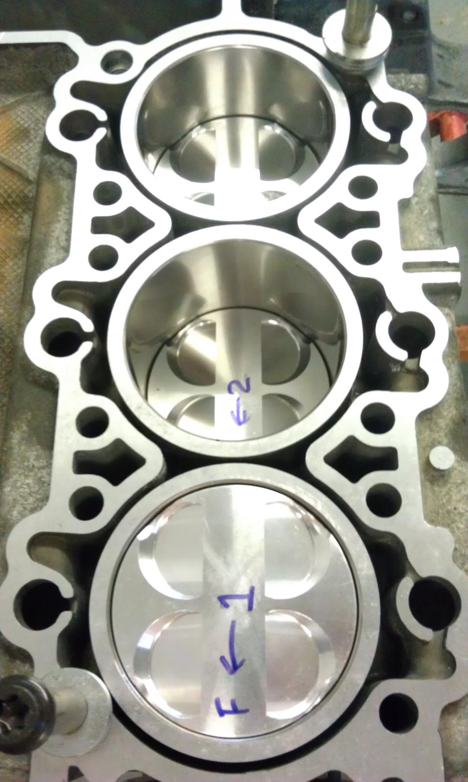

questions for my fellow engine rebuilders;
heres what ive done so far.would like to get others input on other parts to replace as part of this large effort;
new parts ;
ln nickies
je pistins rings
rr rods
new oil sprayers
arp carrier bolts
new bearing shells
balance reciprocating assembly
billet tensioner paddle for crank to ims shaft
ims retrofit and ceramic bearing
new IMS oil baffle gaskets ( $75.00 what a rip off)
all new chains
tensioner paddles
hardened oil pump key
valve job, new seals and reused existing valves
new aos
resize/ increase injectors to accomodate increased displacement from 3.4 -3.6 (part number ?)
questions:
replace all lifters ?
intake to exhaust cam chain cylinoids?
Whart else am I forgettting ???
thanks guys. not asking for a primer in engine rebuilding, just want to know what others have done to head off the "yo dummy, why didnt you replace the (fill in the blank) when you were rebuilding and had the motor out ?"
If my wife knew what I've spent on parts and machine work...she probably does ; )
Water pump
Idler pulleys
Plugs and coils
Clean out your SAI ports
New serpentine belt
Air cleaner filter
Oil filter/Oil
Guessing you probably already know these items, but thought I would throw them in there!
Replacing lifters is a good idea. They often get stuck and affect the performance. I know I replaced all of mine when I did some engine work a few years back and several were stuck. Porsche has a superseded part number at a higher cost but you can still get the originals at a lower cost under a BMW part number.
