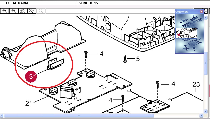

I have the same problem with a failed light switch but in addition, the sunglass holder latch has failed. The dealer quoted me $443 for repair.
$209 parts and the rest labor. Here are the parts:
I think the $84 part is the dealer repair kit for the melted light switch.
The $33 part is the latch for the sunglass holder.
Not sure what the $91 'cap with symbol' is.

My car's sunglass holder latch is also broken and today I've just received my ordered part below from Suncoast.
955-555-557-01-5Z1 RETAINING FRA $70.96
I am plannig to install it tomorrow or on sunday.
I would also recommend the interior led kit I bought for Cayenne which is also available from Suncoast. The installation was easy and I did it myself.
http://www.suncoastparts.com/product/PKLED955.html?Category_Code=9552Elec2009
'Cap with symbol' are the light switch buttons on the retaining frame that are sold separately. You need them if they are melted.
Yo may want to get a quote from suncoast for the part numbers you posted.
Cheers.
Share this post
Thanks much for the info and the correction. So any idea what the 'push button catch' is?

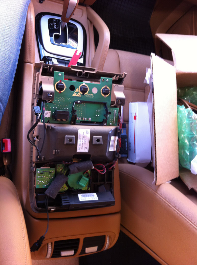

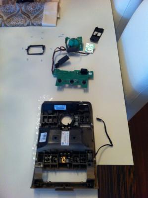

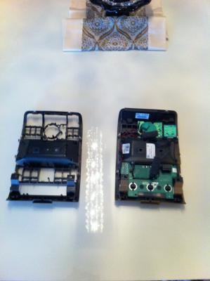

It took me 2 hours to replace the retaining frame. There are a lot of cables and parts attached to it...
This is the photo of the latch that was broken:
post-72831-0-52142400-1349536679_thumb.j
These are some additional photos...
post-72831-0-65733500-1349536725_thumb.j
post-72831-0-08899200-1349536739_thumb.j
post-72831-0-36295100-1349536752_thumb.j
post-72831-0-15593000-1349536763_thumb.j
Everything is working fine.

I take it you just methodically swapped all of the 'guts' over to the new frame, right?
So did you find that both the frame AND the 'push button catch' were defective? Did you replace both or just the frame.
Thanks for going through the effort of posting some pics.

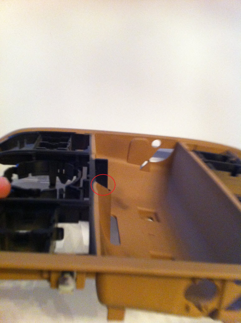

So I FINALLY got this project completed. It was the last on a list of annoyances.
As to the sunglass holder:
Once I got the assembly removed, it seemed to be functioning OK...of course. But I already had the frame and latch assemblies on hand so I went ahead and changed those parts out. The only thing that was a little tricky was getting the sunglass holder springs back in place. They have kind of a weird bend on the end which made them tough to get inserted into position. Everything operates good now.
My observation: I don't think I needed the frame assembly for this problem because the only way it interacts with the latching mechanism is to accept the two tiny screws which hold the latch in place. I'm not sure whether the latch needed to be replaced or not because it seemed to be working after I removed the console. Oh well...works now.
As to the light switch:
After replacing the frame, all of the buttons and the switch mechanism, I put the console back in place and the same problem persisted. Aaaaggghhh! Next I ordered the chassis which the switch mechanism slides in. After replacing that part, everything works great!
My observation: After taking a closer look at all of the removed parts, I found that there was some melting in the switch chassis---the only part I really needed and the last part I replaced, of course. The plastic had raised a little bit around one of the metal terminals so it was holding the switch contact a little high, breaking contact. What I think would have worked, without buying any new parts, would have been to file or sand down the little high blobs that were holding the contact away.
Not too hard of a job but definitely a design flaw.
Oh, one more thing, be careful with the screws, I broke one. They are a little resistant when threading them fresh into untapped holes.
