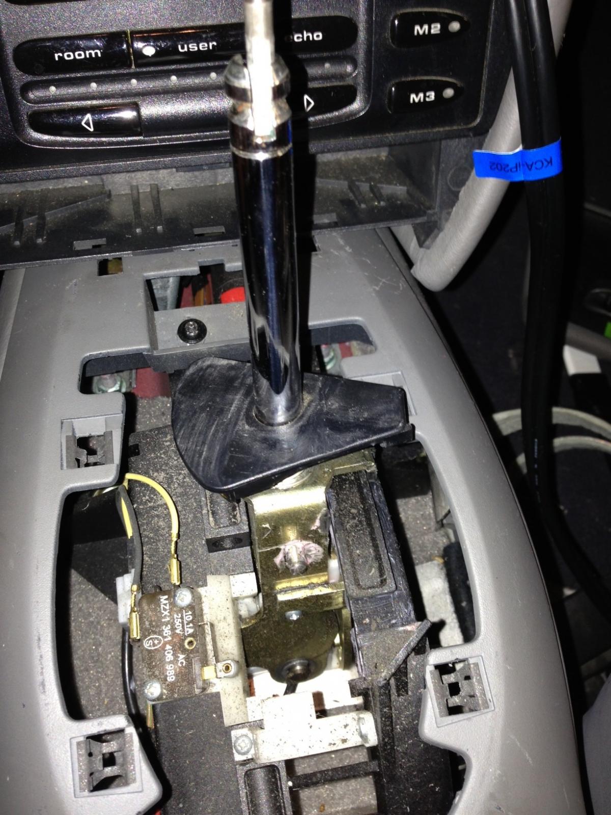

Ok, got the parking brake microsensor back in and I'm having some challenges getting the tiptronic shifter assembled properly.
FIrst challenge was the retainer spring clip that would go all the way in. Finally I pushed it with the edge of a screwdriver and voila! it is in (30 minutes later of course)

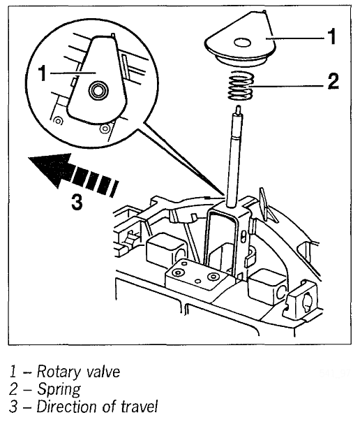

Now my problem is that the shifter clunks through the gears and is hitting an obstruction as it moves from D to M and back again. There is a funny shaped piece of black plastic with spring attached that goes right under the shifter cover. It has a hole in which the shifter shaft passes through. How does one properly orient this funny shaped piece of black plastic?

Thanks for the diagram Loren... if you could help me understand it, by confirming...
The direction "3" is from P to D (toward the rear of the car)?
The longest edge of the plastic is oriented so that it's perpendicular to the shifter travel, and it on the "D side" (as opposed to the "P side")?
Thanks as always for your timely and authoritative responses!

Removing and installing selector support
Removal
1. Remove selector knob (refer to Service No. 3704 19).
2. Remove center console (refer to Service No. 68 17 19).
3. Move selector lever to position "D".
4. Disengage keylock cable:
- Open adjuster (3) by pressing the unlocking button (7). Press the retaining clip (4) together and carefully pull the adjuster (3) upward out of the support bracket.
- Disengage cable nipple (1) on the keylock lever (2).
5. Disengaging selector lever cable:
- Slide the locking sleeve of the adjuster forward and turn it clockwise to removal position (8).
- Press the retaining clip (10) together and carefully pull the cable upward out of the support bracket.
6. Disconnect plug connection.
7. Unscrew fastening nuts (11).
Installation
Install in reverse order, observing the following points:
1. Tighten fastening nuts (11) to 10 Nm (7.5 ftlb.).
2. Fastening selector lever cable:
- Press the cable into the support bracket until the retaining clip engages in the housing (10).
- Press cable into the open adjuster (8) and close the adjuster (9). The locking sleeve must move to the end position automatically(9).
3. Fastening keylock cable:
Note
Adjust the keylock cable only with the selector knob fitted.
- Install selector knob (refer to Service No. 3704 19).
- Turn ignition key to position "1" (ignition on) and move selector lever to position "D".
- Open adjuster (3).
- Engage cable nipple (1) on the keylock lever (2).
- Press housing for adjuster (3) into the support bracket until the retaining clip (4) engages.
- Move selector lever to position "P" and turn ignition key to position "0" (removal position).
- Press cable sleeve (5) toward the selector support.
- Release cable and press locking button (7) until it engages.
4. Check keylock function:
- Turn ignition key to position "1" (ignition on).
- Move selector lever from position "P" to "D" and turn ignition key counterclockwise. The removal position must not be reached.
- Release ignition key again and engage selector lever position "P". In this position, it must be possible to remove the ignition key and the locking button must be locked.
5. Remove selector knob once more.
6. Fit rotary valve in correct position and install center console.
Share this post
Ok, got that done!
Now one question left.... in removing the center console I disconnected 6 connectors under the ashtray. All easy and obvious to reconnect except the storage bin alarm wire. I didn't pay close enough attention to where it came from as I was disassembling (it fell apart without needing my deliberate effort) and now I don't have a clear idea of where the other side of the connector (the side attached to the storage bin lock) is or how the heck I'm supposed to get my hand in there to make the connectors connect. Any ideas or hints appreciated....because I really don't want to disassemble the whole console again just to put that one connection back!
