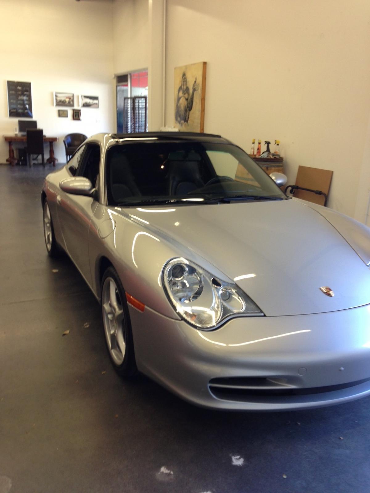

Recently purchased a 2003 996 Targa and now unable to open the rear hatch either via remote or the direct button on the door sill.
