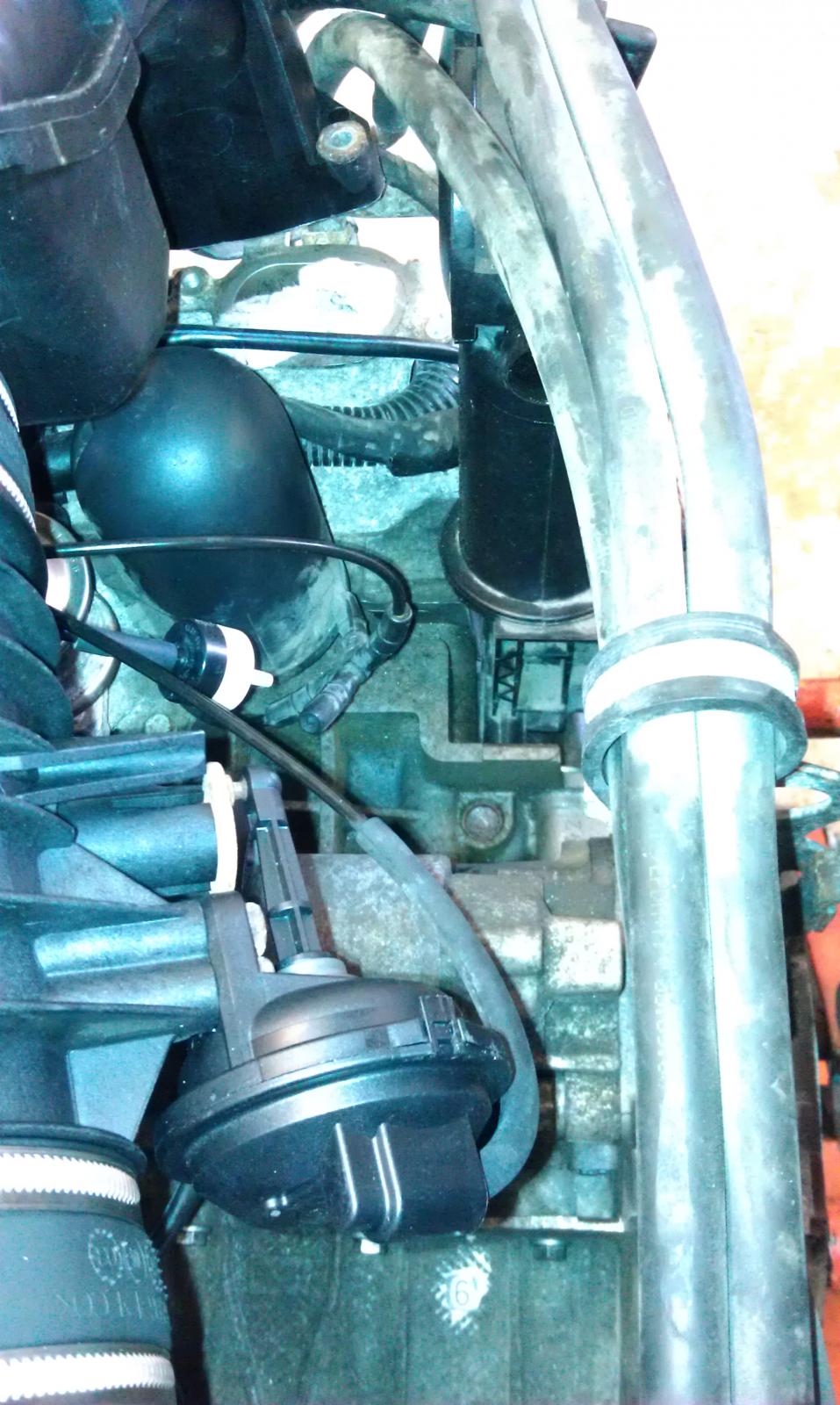

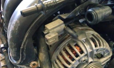

look at attached pictures. this is on a 1999, carrera cabrio, six speed I am assembling. your part mounts on front left intake manifold bracket. and the vac hoses go the rear of engine; one connects to the black cannister 'spider" and the other to the flapper on the rear intake runner.
good luck
