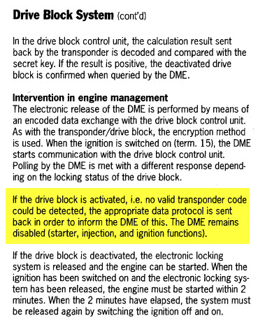

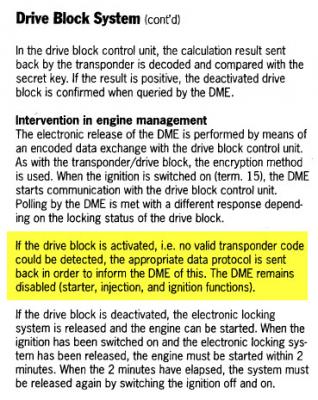

If the car won't turn over I don't think it is the immobilizer. This prevents it from starting but not from turning over. May just be a failed starter motor.
I'm afraid that isn't correct. The immobiliser inhibits the starter, fuel pump, and ignition:
post-4000-0-18344900-1354021868_thumb.jp
I'm not saying that it is the problem - only that it could be.
You will find the starter relay on the panel under the carpet behind the back seats. The starter is triggered by the DME, but it could still be the ignition switch causing the problem. A little unlikely, perhaps, as the switch contacts handle very little current. They do break up mechanically inside the switch though. The first sign of failure is usually when you have trouble removing the key, or when it doesn't spring back.
