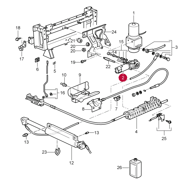

Thanks for the reply. I'm replacing the motor used to open the cab cover. The same one with the blue clutch for emergency operation in the middle of the rear panel of the interior. It connects to the cable drive assembly with the "cover closed" microswitch on top. Sorry I can't post pictures, but hope someone knows what I'm talking about.

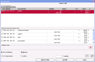

If it helps, here are the part numbers for the motors:
old
Hmm... PET shows that 996.561.933.01 is for MY04 and newer.
It also shows for MY03 and older 996.561.933.00 with additional parts.

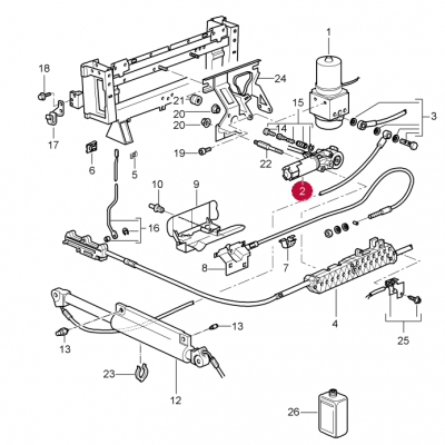

Here are a couple images... click on them to enlarge them
Replacing the cables also or just the motor? Motor swap is pretty simple with removing the screws and then opening with undoing clips. Then put the ends of cable back in along with sliding pieces and snap together (may need some grease if new).
Mine had the ear broken off that slides to lock the clam shell. I replaced the entire assembly and didn't have the new part in the s,e position as the damaged one. It became a calibration nightmare. I ended up with a good extra motor assembly but just sold it about a week ago. The motor is held on by 2 10mm long shaft bolts. Just unbolt them and it should come right off.

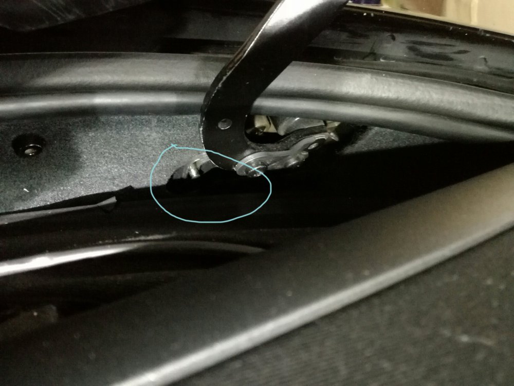

Hello,
i think i have a similiar problem on my 997 turbo cabriolet.
My cover only opens on one side, the other is stuck.
I opened it manually with a piece of wood where i drilled a hole so that i can push the cover/pin which was stuck.
Here is a pic of the pin that i pulled a bit so that i could open the cover.
The cover damaged the paint at it tried to open on one side and not on both.
I opened the top while i drove about 30km/h and i heard a metal noise when the cover closed.
After that i could not open it and so i made it by hand.
