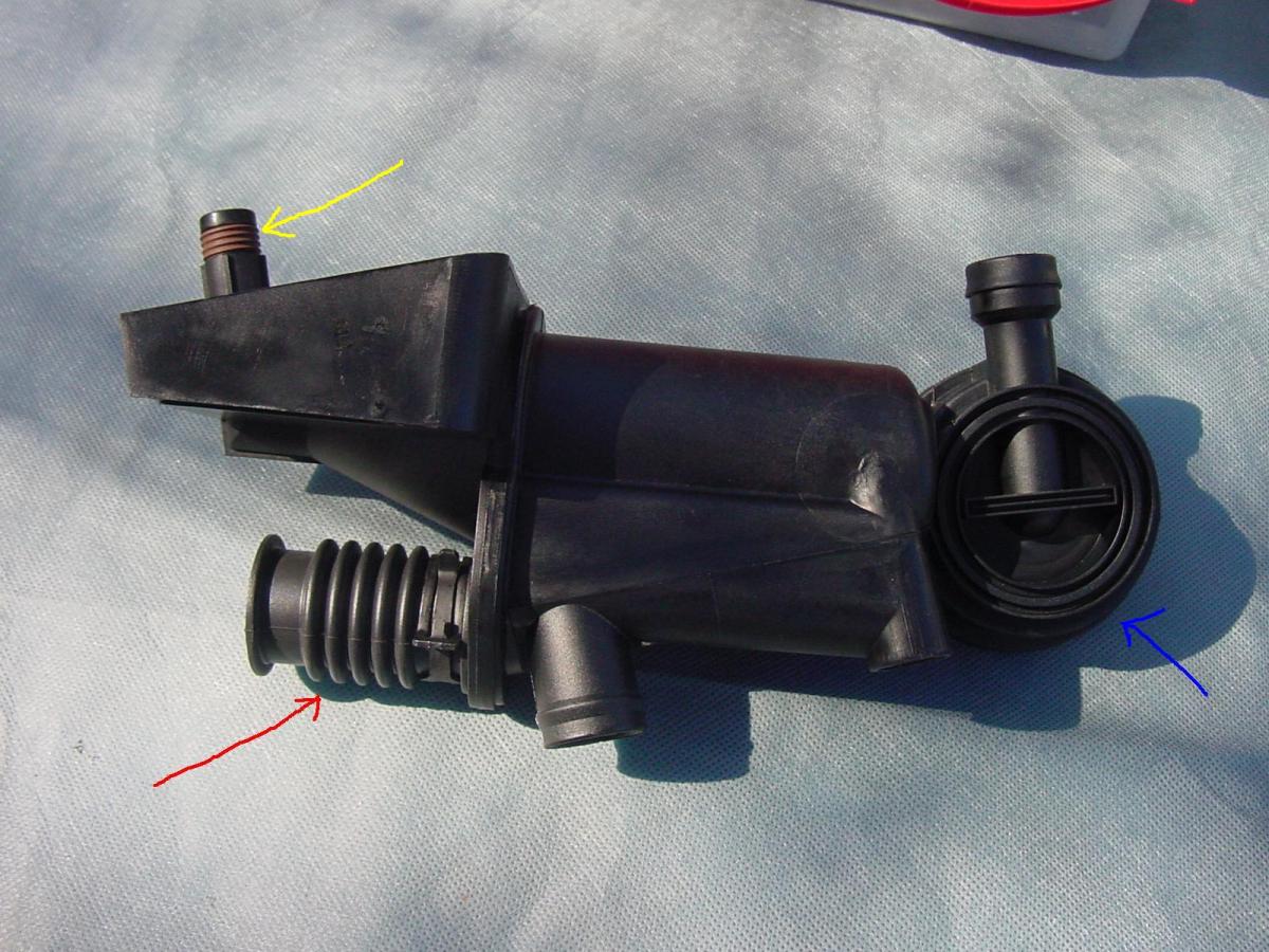

I think that the early Boxsters (97 & 98) had the AOS with the round part that is on top situated horizontally. In 1999, they "updated" the design and the AOS now sported the round part in a vertical position. AFAIK, you can only buy the "new" version AOS and that may be why the AOS is (perhaps mistakenly) listed as being from '99 on in the parts list.
If the new one you purchased has the round part in a vertical position, it's the correct one.
Here is a photo, with a blue arrow pointing to the "round part" to which I am referring:
post-6627-0-92644000-1356222074_thumb.jp
The part for which you asked the part number has a yellow arrow pointing to it.
Regards, Maurice.
