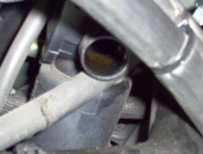

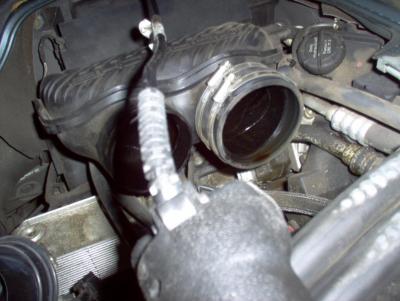

DOH!! OK here are the pics. Started taking the AOS out, figured since I have one on the shelf I might as well change it. Only issue so far is the pipe the the left side of the engine is being a bear to get released from the AOS & there seems to be a electrical connector bracket preventing the last 1/4" of removal. I'm gonna get some rest & tackle it again in the morning.

It would be best to start by replacing the AOS and carefully checking the oil level in the engine first as these are more common issues.
The scavenging pumps are mounted on the ends of the cylinder heads, and are self contained units that are driven by the cams. A lot like light bulbs, they either work or they don't. To check them, they have to be removed. Here are what one from an X51 M96 look like for example, you can see the drive tang that runs them:
There are two pumps, one each on opposite ends of the engine, and they are removed from the outside of the engine. If you have to get into them, remember that the two are not the same, they are specific to the cylinder head they came out of:
I would do the AOS, clean out the accumulated oil in the intake system and check the car's oil level before even thinking about the scavenging pumps.
OK, I got the AOS changed (not all that bad of a job) & cleaned and as much of the oil out as I could.
