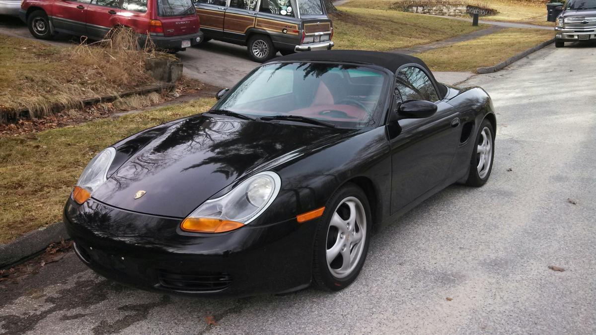

The issue i'm having currently is with the top. I had a cracked rear window on the car when I purchased it so I removed the top and assembly to take to an upholstery shop to have a new window sewn in. I had the top in "service mode" and was able to remove the top and frame without issue. The problem is instead of leaving the top in service mode with the clam shell open (as I should have) I lowered the clam shell without refitting the top and now for the life of me cant get it to re open. I'm sure this is a result of not having the top on the car since it opened and closed fine before but I cant re install the top until I get the clam shell to open back up.
